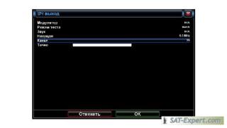

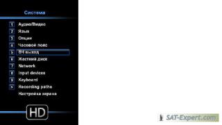

Появился RF модулятор.
Но больше из заявленного:
Changing of Resolution ( Added in driver, please wait for Plugin for E2 it is under work ).
Contrast settings ( Added in driver, please wait for Plugin for E2 it is under work ).
Hue settings ( Added in driver, please wait for Plugin for E2 it is under work ).
Saturation settings ( Added in driver, please wait for Plugin for E2 it is under work ).
Brightness settings ( Added in driver, please wait for Plugin for E2 it is under work ).
Aspect ratio ( currently in coding stage )
