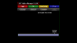

richjuks
Hello, all.
Today I installed Hot Summer Image for my Kathrein.
There is one big problem - AAF Addon-Manager V 2.09 is not working.
When I want to download something I am getting error - Cannot parse feed directory.
Is there any solution for this?
How can I install camd3 protocol???
