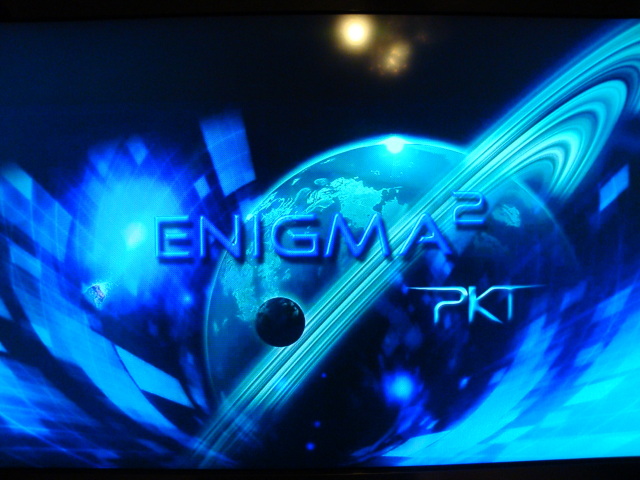

Новая версия энигмы2 для Octagon 1028P от команды PKT :
PKT SF1028 Enigma2 Nibiru V3 Image
Enigma2 OpenSource SH4 Duckbox Project GIT-1984 PKT mod SVN-788 Nibiru V3 Image
Image is designed for installation in USB/SATA disk
Support receiver: Octagon SF1028/AT-7500/other clons
Added by sh4 Duckbox Team:
- fix player CCFLAGSY position
- add ifo support
- [libeplayer3] fix xvid videostream in mp4
- [libeplayer3] hopefully fixed zdf streaming problem without destroying playback of other h264 files
- fix was_timer_wakeup
Added by PKT:
[ALL] PKT channel control fix
[ALL] add smooth infobar in PKT Skin Setup
[ALL] fix memory check
[ALL] channel list update
[ALL] Infocenter fix
[ALL] set EN as default Menu language
[ALL] picon update
[ALL] update DreamEplorer v6.9
[ALL] update DMnapi v1.3.19
[ALL] add new allienHD
[ALL] gbox start fix
[ALL] DTS Downmix Support
[ALL] new PKT MediaCenter
[ALL] add jfs filesystem check if octagon box detect before mounting
[ALL] startup script code optimization
[SF1028] brightness & led power adjust
[SF1028] remote control tuning
[SF1028] add WIFI drivers
